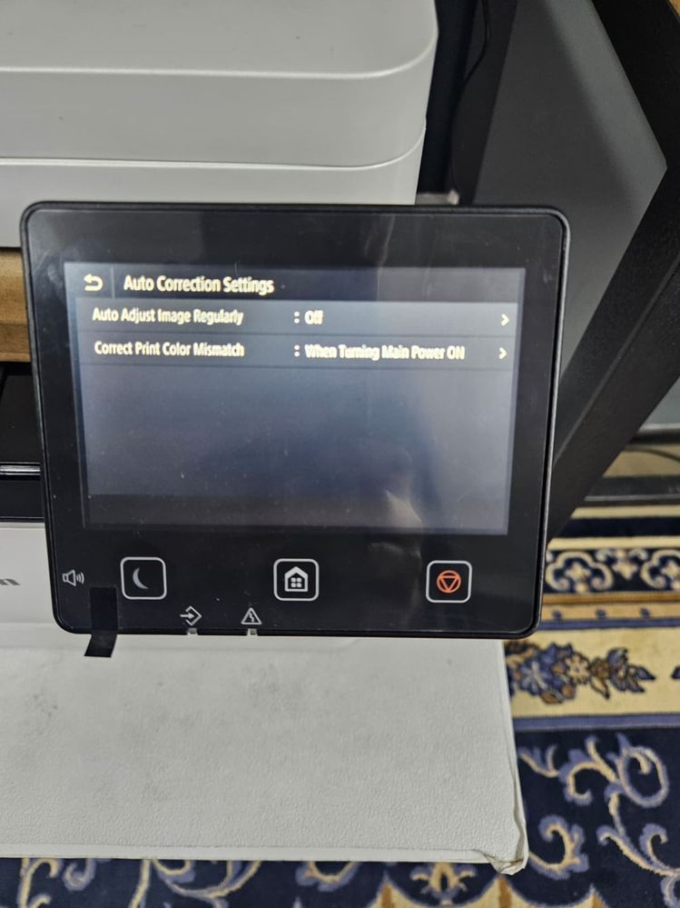

Not sure about the "replace cartridges," but the sounds can be the printer doing auto-correction. You may want to go into the Menu-Adjustment/Maintenance-Auto Correction Settings and Correct Color Print Mismatch and turn off the auto correction. These corrections do use toner, so the toner levels may be lower than you think, and the starter color cartridges are low capacity. And many "black" printouts also use color toner. Did you look at your actual cartridge levels?

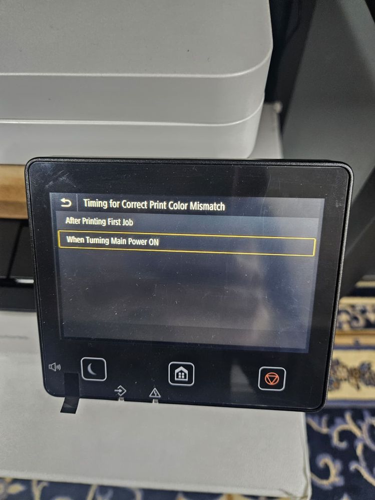

01-11-2026 12:23 AM - edited 01-11-2026 12:40 AM
there is not turn off option. its either "when printer start" or "after first print job".... how can i turn this feature off ?
