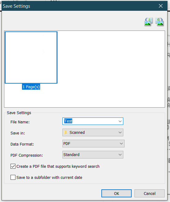

02-11-2021 07:16 PM
Oliver,
After scanning a document on my ImageClass MF249dw, I do not see the Output Settings Icon. See attached.
Am I missing something? It would be great to not have to delete the date appendage for every document I scan!
06-08-2023 08:14 PM
Same issue on a Laser Color printer MF741Cdw, purchased in March 2023, 4 years after these posts.
There is no box named Advance Settings Dialog Box.
User interface is the same as described above by CBolin.
For my application, this is a MAJOR issue to have to touch every filename and remove the date + 4 digits.
The date can be prevented to be appended automatically if the box "Save to a subfolder with curent date" is checked
This box is found in Settings, prior to selecting the type of Scan to perform
But it seems there is no way to prevent the addition of the 0001 ( incremented by one after each time) in the filename.
