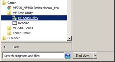

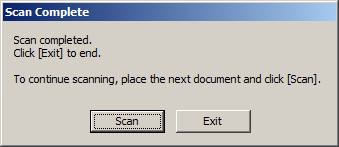

I had the same problem with my Canon ImageClass MF726Cdw, but this is how I found a solution:
1) Go to Canon MF Scan Utility... (menu image from Windows 7)
2) Settings
3) Scan Options
Scanning Method = Auto Mode, and select "Scan both sides when scanning from feeder"
This worked for me. I scanned two pages (3-sides), and the software created one file with three pages.
