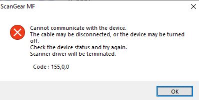

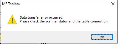

I am having a problem with my ImageClass MF4890dw when I try to scan a document.
It usually starts scanning fine but when it seems it is almost done it stops, the printer beeps and shows the following message in the display: 'An error has occurred. (see below)
Also the MF toolbox software reports an error (see below).
My printer is connected through wifi and it works great when printing.
I have Windows 10, MAC and Linux and all three have the same problem.
Every once in a while I am able to finish the scan, and I get a perfectly good scan but this is may be 1 out of 30 tries which is unacceptable.
I have gone through the instructions in the drivers download page including installing the patch but it doesn't help.
I have updated the firmware to the latest.
I am feeling frustrated that I bought a scanner/printer combo and I just got a printer.
Please, let me know if there is anything else I can try.

Canon's recommended solution is here:
https://support.usa.canon.com/kb/index?page=content&id=ART164453&actp=search&viewlocale=en_US
I'd start with the Patch... which has specific installation steps.
[Windows 32-bit & 64-bit] Patch for Network Scan, USB Scan
I cannot confirm it as I do not own this printer.

Hi dasosamar.
