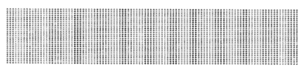

I am having troubles with my Printer after the update from Apple OS Catalina. My printer still prints to a certain degree. It does not print properly. I have printed both on the web browser using Safari and Chrome, and both cannot print any QR codes. This is the outcome of the QR code for a printout of any Insurance Identification Card:
It also cannot have a proper aposthope on any sentences. This was printed when the file was saved as a PDF first, image also below:

FYI: QR code should lool like this when printed propely.

The inability to print an apostrophe correctly points toward the issue being with encoding in the document, and/or language settings both on the PC and in the program: essentially a problem with Fonts. Such a problem, where the data is in one font and the computer is force-interpreting the information as a second font, generally occurs before the data reaches the printer driver.  It would explain both the apostrophe changing, as well as the inability to print the QR code (it doesn't comprehend the QR code "font" data).
If there is a problem with the driver, ensure you're manually selecting the Canon-produced drivers in Use drop-down of the Add New Printer or Scanner window.  The default for printers often are Bonjour/Airprint drivers, and manually selecting the Canon-produced drivers may resolve some of these issues.  If that doesn't correct the problem, the soluttion will be found somewhere in the font/language data on the computer, or in the program from which you're printing.
