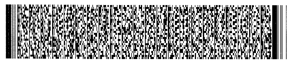

I am having troubles with my Printer after the update from Apple OS Catalina. My printer still prints to a certain degree. It does not print properly. I have printed both on the web browser using Safari and Chrome, and both cannot print any QR codes. This is the outcome of the QR code for a printout of any Insurance Identification Card:
It also cannot have a proper aposthope on any sentences. This was printed when the file was saved as a PDF first, image also below:
I have update all the firmware for my printer on my computer and the physical printer itself. I alse remove the files and re-installed all the local directly on my mac from its "library/printer..." sub folders.
Apple representative claims that this is a problem from Canon Company itself, not from them. Canon can say the same that the current Operating system undoubtedly cause this problem; since they claim that the previous Operating system and their compatability chart indicate that this should not occur.
This is a normal case of, toss that hot potato to someone else.
I am running out of time, and perhaps my sanity to listen to the same scripted excuse over and over. I do not believe i could be the only individual with this very distinct problem.
FYI: QR code should lool like this when printed propely.

Hi dykris00.
The inability to print an apostrophe correctly points toward the issue being with encoding in the document, and/or language settings both on the PC and in the program: essentially a problem with Fonts. Such a problem, where the data is in one font and the computer is force-interpreting the information as a second font, generally occurs before the data reaches the printer driver. It would explain both the apostrophe changing, as well as the inability to print the QR code (it doesn't comprehend the QR code "font" data).
If there is a problem with the driver, ensure you're manually selecting the Canon-produced drivers in Use drop-down of the Add New Printer or Scanner window. The default for printers often are Bonjour/Airprint drivers, and manually selecting the Canon-produced drivers may resolve some of these issues. If that doesn't correct the problem, the soluttion will be found somewhere in the font/language data on the computer, or in the program from which you're printing.

Thank you for your advice. I have done majority of what your mention before posting this. I am not implying you might be wrong.
It is highly that it is with the Operating System itself (OSX Catalina). The printer works fine from printing using and Android Cellphone. Using an Iphone results in the same problems as from printing using the Mac either from an internet browser or a saved PDF version of the document in question.
From the default printer you mention, i did removed it at first. Then, added it manually to select the Drivers from Canon Directly instead of just trusting Bonjour. That didnt work.
I have check about the Font, and language setting. That should not be the case, but i will check it out this weekend when i have time. My Hypothesis is that it wouldnt be the case, since it printed fairly well without problems from the Previous Operating System (OSX Mojave).
