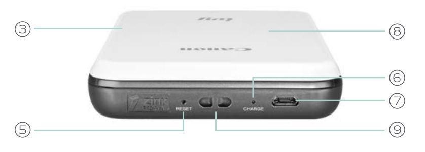

5. Please obtain a paper clip or something small such as that. Please turn your Ivy printer on and then insert the paper clip into the hole labeled "Reset". It is #5 in the image below. hen you insert the paper clip, you should feel a button depress inside the printer. Hold that button down for 4-5 seconds and then remove the paper clip from the hole
The printer should then again appear in the Bluetooth list on your phone. Connect to it and then you should be prompted to open the Canon app.
