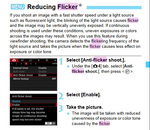

I am specifically interested in which 1DX and 5D models might have anti-flicker. I know that the original 1DX does not.
06-26-2020 12:41 PM
I just went to the Canon support site and got the 5D Mark IV manual. I then did a search for "flicker"
I will leave the rest for the interested reader.

I looked in the specifications, but could not find it, that is why I went to the manual.

06-27-2020 12:15 PM
Anti-flicker was added to the 1DX series with the Mark II, I shoot with 1DX, 1DX II, and 1DX III bodies.
I shoot a lot of high school sports both gym and field (football and soccer) and I leave anti-flicker off on the II and III because it is incredibly rare for me even with high speed continuous drive to capture an image where flicker is an issue and having it on changes shutter lag and frame rate. Newer high efficiency LED drivers used for high intensity lighting are of the PWM type so the flicker rate will vary and none of the anti-flicker in camera camera systems will work because the flicker rate varies and these systems are designed to work with the older HPS and other gaseous type high intensity lighting that is tied to either the 50hz (most of the world) or 60hz (US much of N. America) line frequency resulting in a regular flicker rate of either 100 or 120 times per second.
