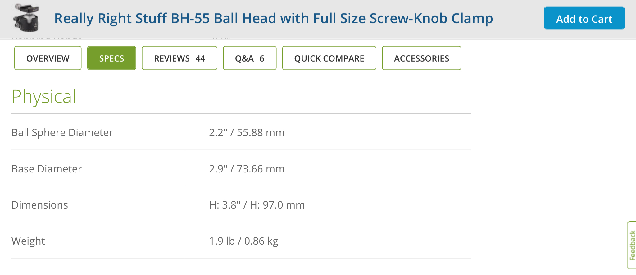

09-18-2021 12:35 PM - edited 09-18-2021 12:41 PM
@Edward1064 wrote:Rodger,
Those are all excellent suggestions, thank you. I looked carefully on the Benro site and they don't seem to offer the legset of the (Tripster) travel tripod I'm considering. I have written them just to be sure. After studying the site, I see another possible issue. While my robust RRS ball head can be mounted on the lightweight tripod legs, the mounting surface on the tripod is meant for a head of smaller diameter so it won't adequately support my head, which is about 2" in diameter. Lightweight travel tripods really aren't consistent with beefy heads, it appears, even though that's what I prefer. The RRS weighs about 1 lb.
I'll look for a compromise in the tripod's size and weight.
Ed
The RRS BH-55 can fit perfectly on a 75mm bowl adapter or flat plate. I have seen at at least one company with 69mm video bowls, which would be too small. I still recommend taking a look at tripods without a center column for greater stability.
Take note of the base diameter.
