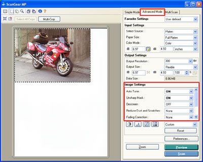

From your example, the problem seems an artifact of the printing method for the originals.
If you haven't already done so, try toggling the Auto Fix and/or Descreen options in the scanning preferences. These settings may be found by clicking the Specify button in the Scan/Import window.

I just took a quick look and I don't see those controls anywhere when I open up the scanner in Photoshop, or when I go to the Scan function in my apps list

Hello.
If you are opening the Scangear interface from Photoshop, go to the Advanced Mode tab. Once there, you can find the options for Descreen and other adjustments.
