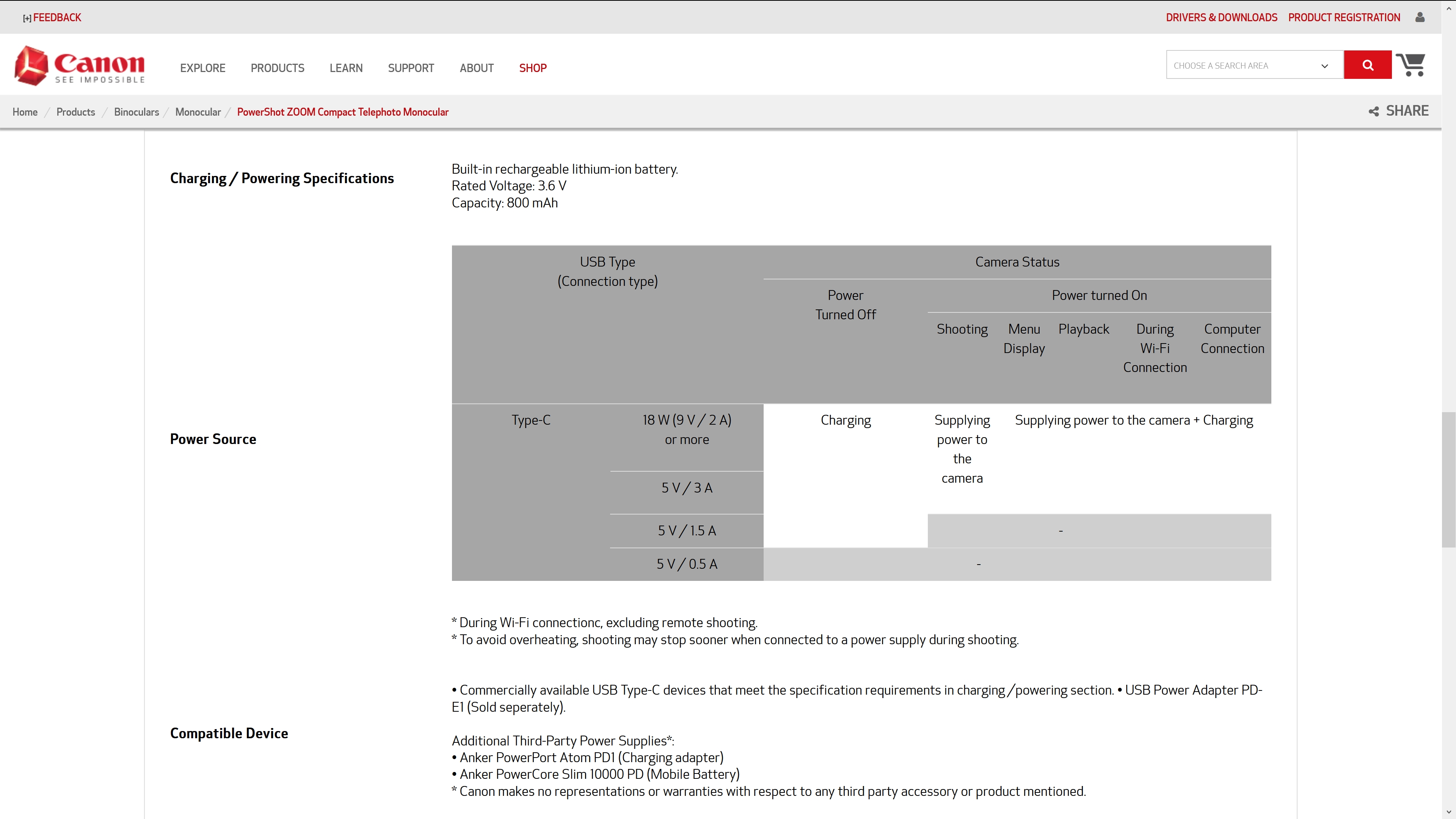

According to the Canon product matrix, a USB C device with a 5 volt output at 1.5 amps is sufficient to charge it with the power turned off and with 3 amps capability it can power the product.

Nope! I have two of these Zoom Camera Monoculars and the ONLY way to charge them is with a battery pack or wall charger that has a USB 3.0 connector and 9VDC/2A output.
This battery pack from Amazon works:
Charmast Smallest 10000 USB C PD Quick Charge Portable Charger, Mini Small 10000mah Power Delivery QC Power Bank, Compact Phone External Battery Pack Chargers Compatible with iPhone, Samsung, Pixel
and this charger, also from Amazon:
Huntkey USB C Charger, 18W 9V/2A 5V/3A Power Adapter, PD3.0 Fast Type C Wall Chargers for Samsung Note10/S10/A8s/S/Note 9/S9/S9+/Note 8/S8/S8+, Pixel 3, iPad Pro 11" /12.9" (3 Gen)etc, 3.3ft C-C Cable
