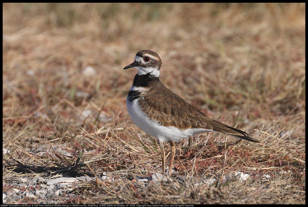

When I go to the wildlife refuge where the birds are more wary, the distances are greater. https://www.rsok.com/~jrm/2024Oct22_Salt_Plains/2024oct22_killdeer_IMG_2135c.html
Killdeer (Charadrius vociferus) at Salt Plains National Wildlife Refuge in Alfalfa County, Oklahoma, United States on October 22, 2024 ; EF100-400mm f/4.5-5.6L IS II USM +2x III ; Focus Distance Lower	18.82 m ; Focus Distance Upper	24.09 mKilldeer (Charadrius vociferus) at Salt Plains National Wildlife Refuge in Alfalfa County, Oklahoma, United States on October 22, 2024 ; EF100-400mm f/4.5-5.6L IS II USM +2x III ; Focus Distance Lower 18.82 m ; Focus Distance Upper 24.09 m

Wow what a massive difference. The 100-400L II is razor sharp while the 70-300+TC is terrible
There are differences other than the lenses.
  • The 3rd party teleconverter is much less expensive than the Canon and produces less contrast at edges. There is greater acutance with the Canon teleconverter but the canon cannot be used with that lens.
  • Over the years my skills have improved.
  • There is much more small aperture diffraction blur with the Kenko than with the Canon because F/16 vs. F/11 and the Canon software likely has better information about the point spread function than does the GMIC Richardson/Lucy deconvolution. ( R/L in GMIC assumes circular aperture and gaussian spread ) ( I might have done better with F/13 instead of F/16 if the biggest problem were diffraction and not focus )
  • The distance is greater between camera and bird with the Kenko which results in more distortion caused by varying air densities, out of focus insects in the air, and dust in the air.
  • I used manual focus with the Kenko and possibly the focus was not as accurate as it might have been.
  • I had better light for the Killdeer than for the Phoebe.
