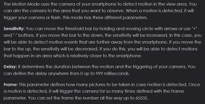

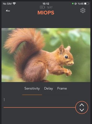

01-08-2026 11:13 PM - edited 01-08-2026 11:18 PM
@JeffreyEttinge wrote:
Do you set the shutter delay in the app or on your camera? I don't see that option on my R8.
In the app. I overlooked the "Frame" setting in my app, so yes, you are able to take multiple frames. Frankly, I don't know what I thought "Frame" meant, but it makes since now... Go figure ¯\_(ツ)_/¯, sorry.
I haven't used this feature (haven't had too) so I can't attest to it's effectiveness.
