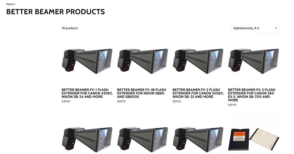

kvbarkley
Many moons ago I read a Luminous Landscape article about the better beamer:

kvbarkley

It is possible to use a an optical lens in front of the Speedlite - like the Better Beamer - to further narrow the angle of the light coming from the flash, and this means that the effective guide number increases by some factor similar to how it does when zooming the flash from 28mm to 200mm.
