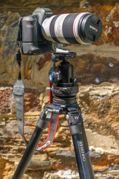

When it comes to a monopod, you want one at least as tall as you,  makes angling upwards so much easier. I use an alloy monopod by Benro, 70+ inches.  I decided to forego carbon fiber for a monopod because the weight savings were not worth it.
Second get a high quality tilt head.  I highly recommend the Kirk tilt head MPA-2. It has amazing friction control.  The mounting plan can rotate 90 degrees.
I just checked the price, see that it’s jumped 50% since COVID.  At that price, it might be painful, but I guarantee you will be amazed and pleased. Cheaper ones are not in the same league,

I like the Robus brand..  It seemed like it came from out of nowhere.  I suspect that is a house brand, but an offfshoot from Benro / Induro.  Robus sells legs with only a quick release flat plate.  I have different plates with different heads.  I can go from a blall head to geared head, to my landscape right now with a leveling base.  It only takes a few seconds.’
This the monopod still being sold that I use with the Kirk head. Why so tall?  For one, I am tall.  Mostly, a monopod is stronger when the leg sections are not fully extended.
