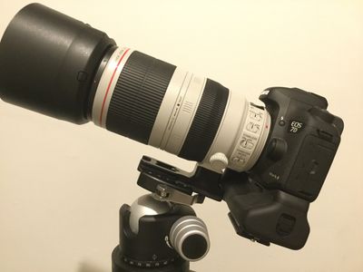

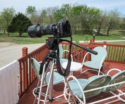

I would say the most support you can give it or get is what you want. This is my rig......................
That's a Sigma 150-600mm f/5-6.3 DG OS HSM Sports lens and a 1 Series camera. It is a pretty heavy package.

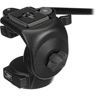

Do you own the big  lens, yet? Because I would say try it out and see.  It’s a safe bet that the micro head will need to be upgrade. Is this the one?
IMG_5655.jpegIMG_5655.jpegFluid video heads tend to have too much dampening for fast action, wildlife photography.
Depending upon how much I might be on the moon, I use a monopod with tilt head or a tripod with a high quality ball head.  In either case, the heads use Arca-Swiss plates

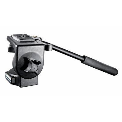

Manfrotto specs it as 13.2 Pound weight capacity.  Lens is 4.5 and camera adds about another pound.  Many sources say you're good to 8 to 9 pounds for the fluid head to work, but it sounds like you'll be well under that weight.  Some folks seem to complain about some shake at it seems the base plate might get loose, but tightening it should fix that.  The Manfrotto page is at https://www.manfrotto.com/global-en/128rc-micro-fluid-video-head-aluminium-128rc/.
It's probably ok, but perhaps just ok as a fluid head is really more for video than photography.  I would agree with Waddiizzle with his "try it out and see" recommendation.  It doesn't appear that it will be unsafe.    The RC2 plate on the lens foot will help balance it out.  I don't know how many tripod shots you will wind up making with the lens in your situation, so trying it out is your best bet to see if it works for you or not and whether you really need a new head.
