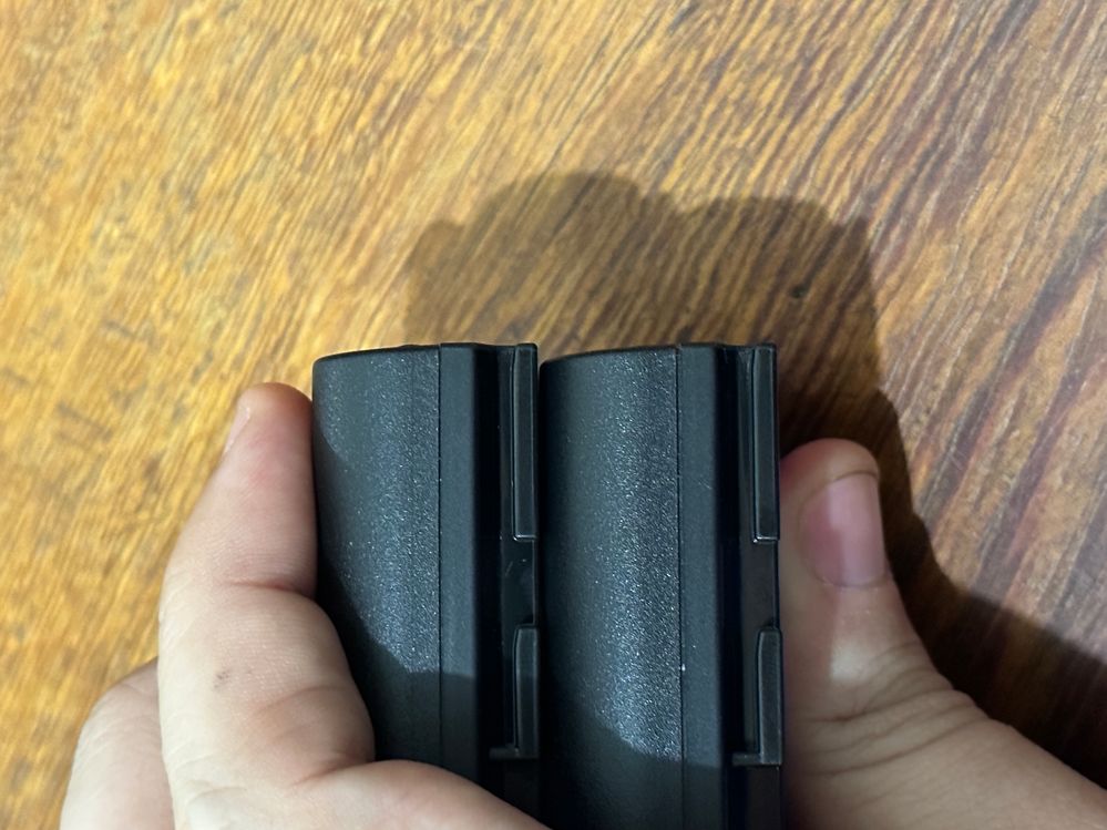

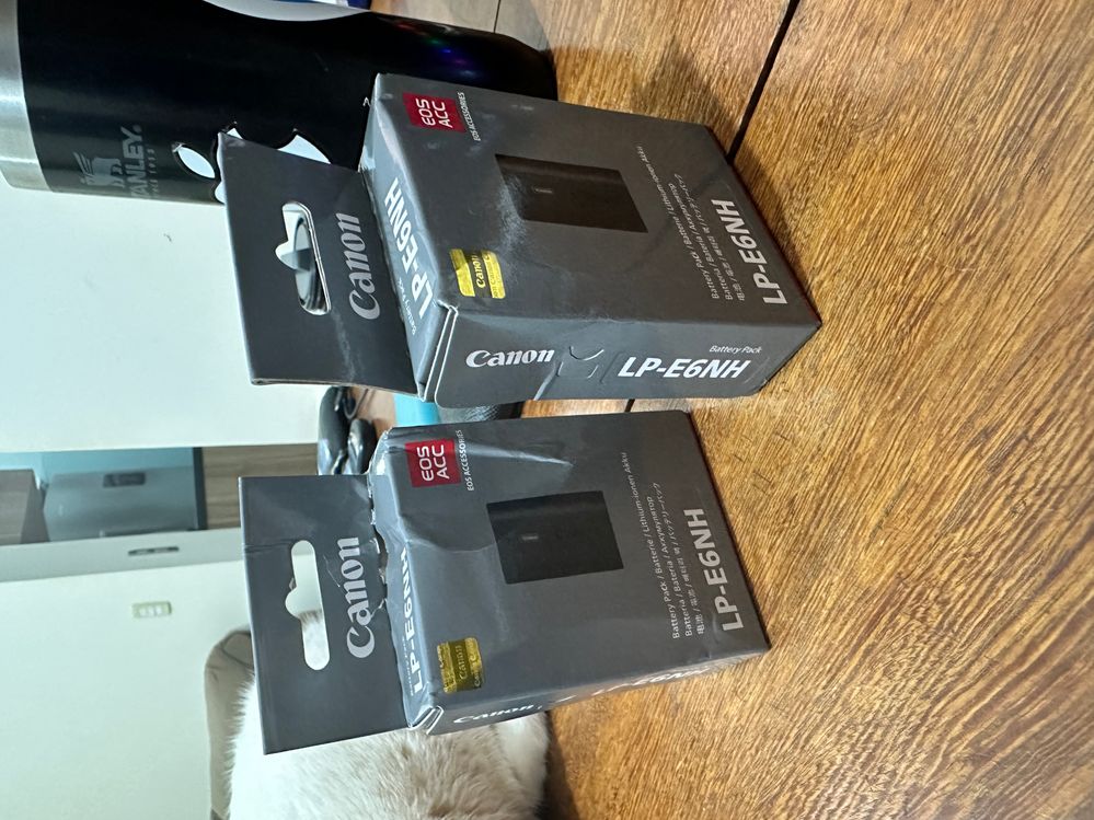

Hi everyone, I'm from Brazil where camera equipment and accessories are double the normal price, so I was shopping around for new batteries and decided on buying from a well trusted site, but that started operating as a marketplace recently, so these batteries came from a third party.
What I noticed about them is that the plastic seems cheaper than my 3 original LP-E6, the fitting of the halves are bad, as is the fitting from that orange cover.
The holographic sticker also doesn't turn green and is off centered, although it features the "canon" and "genuine" words as you move them.
Both also feature the same serial number on the back "2021036A".
Did I buy fakes?No green on the holographicNo green on the holographicBaterias-Falsas-2 - HOLOGRAFICO ERRADO.JPGSame serial number on bothSame serial number on bothPoor fittingPoor fittingPackagingPackagingIMG_3448.JPGIMG_3449.JPGIMG_3450.JPG

I was referring to the one in the little box on the bottom left. Yours are both different, as well as the labels. Mine seem to be fakes, I just talked to the company for a refund. Thanks!
I suspect a production date code is in the lower left corner.
Yeah, the holo won't change to green even in the sun.
I also charged one to the point were my charger said it was full, and as I put in the camera the battery info said it was at only 88% capacity. I put the second one also, and while the codes are different, one is 7 digits and the other is 8 digits.Charger said the top one was Full. Also 7digit and 8digit serials.Charger said the top one was Full. Also 7digit and 8digit serials.
I believe the codes in the lower left are production date codes, not serial numbers.  Those stamps are not the serial numbers reported by the camera.  Mine are different because they likely came from different production runs.  Yours may be from the same production run.

The holograms on the outside of his packaging look different from mine.  Mine only says Canon once in larger letters.  They change color correctly in sunlight.
My EAN/JAN and UPC match his (back of box) as does the MC # at the bottom.

One thing that I noticed on all examples of genuine canon batteries that I found is that the Canon logo on the holographic sticker is centered and the stickers themselves are perfectly centered in their little recess, mine are off and poorly placed.
