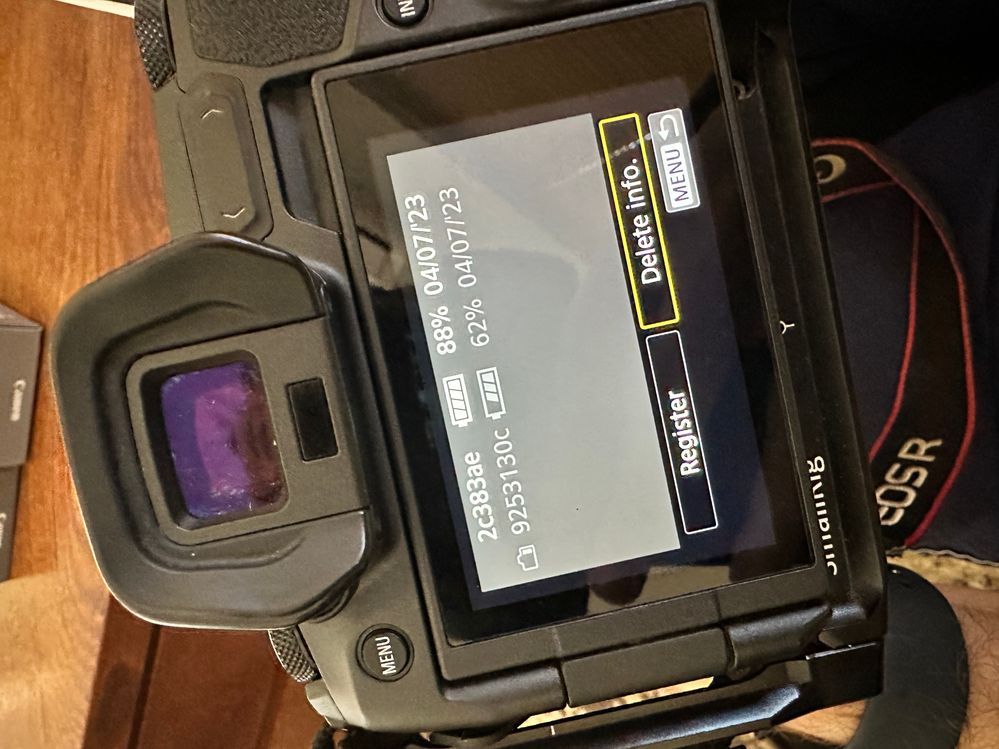

I also charged one to the point were my charger said it was full, and as I put in the camera the battery info said it was at only 88% capacity. I put the second one also, and while the codes are different, one is 7 digits and the other is 8 digits.Charger said the top one was Full. Also 7digit and 8digit serials.

@matheushill wrote:Yeah, the holo won't change to green even in the sun.
Do your batteries report their recharge performance, from the previous screen? Most counterfeits report a date, not battery health.
