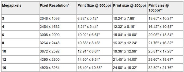

If you have this information mglotspeich my apologies for being redundant.
To kvbarkley's point, the calculation for determining reduced megapixels using an EF-S lens on a full frame sensor. Verify the crop factor of the camera that you will mount the lens onto, for Canon it is typically is 1.6x (Canon does have several choices, the camera defaults to 1.6x). This means the sensor is 1.6 times smaller in linear dimensions compared to a full-frame sensor.
Square the crop factor, to calculate the reduction in area you need to square the crop factor. For a Canon camera it would be 1.6x1.6 = 2.56
Calculate the reduced megapixels by dividing the full-frame camera's megapixels by the squared crop factor.
Full-frame camera: 24 megapixels
APS-C sensor (Canon): 1.6 crop factor
Calculation would be 24 / (1.6 * 1.6) = 9.375 megapixels. The resulting image will have approximately 9 megapixels
The chart below is a general rule of thumb. It represents very good print quality being viewed at a close range. Size can be made larger but some detail may be lost.
