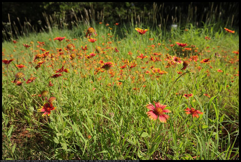

If the camera saved all of the raw files as well as the composite, exiftool may be used to list the time for each photo including subsecond time.
exiftool -h -datetimeoriginal -SubSecTimeOriginal ../2024Jun02/IMG_00[01][0-9].CR3

While I am not especially skilled at this and some of these flowers moved, here is an example:
https://www.rsok.com/~jrm/2024Jun02_birds_and_cats/2024may27_wildflower_IMG_0009-0016c.html
Gaillardia pulchella wildflowers (depth composite of 8 images) in Norman, Oklahoma, United States on May 27, 2024
08-31-2025 07:53 PM
That is quite difficult to have so many flowers behaving. If that sub sec means millisecond, 15 sec for each frame would be very impressive!
