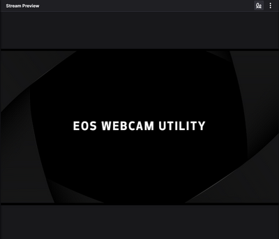

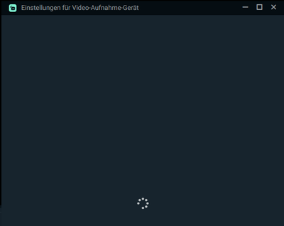

11-25-2024 05:44 AM
Hi Stephen,
Thanks for getting back to me. Unfortunately, there isn't any support for my camera in Europe.
I noticed that the Rebel T7 is only listed in EOS Webcam Utility Pro 2.3 version. As you can see in the screenshots I've attached, I'm having the following issue: My camera isn't even connected to the PC, but for some reason, EOS Webcam Utility is blocking other apps from accessing the camera. I've adjusted the camera's privacy settings to allow apps to access it, but the problem persists. I've also checked Task Manager to see if anything else was using the camera, but I couldn't find anything. Could the reason be that I'm not in the United States?
