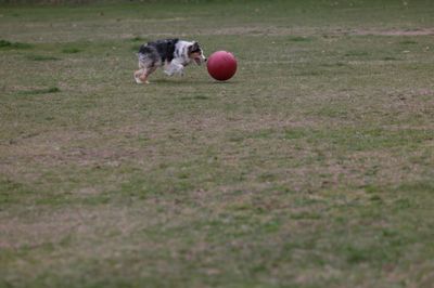

Well,I ditched BBF simply because I can rely on the R5 to do what I want focus wise. I may try it again after a spell - if I find I am not getting good shots…. It didn’t fail me tracking my Aussie playing with her herding ball…
If that is what you want to stick with, 👍🏼. As to this pic…. Try for a higher shutter speed… see if that makes a difference. If you can bump up the ISO, you may even be able to stop down a bit for some depth of field…. Good luck!

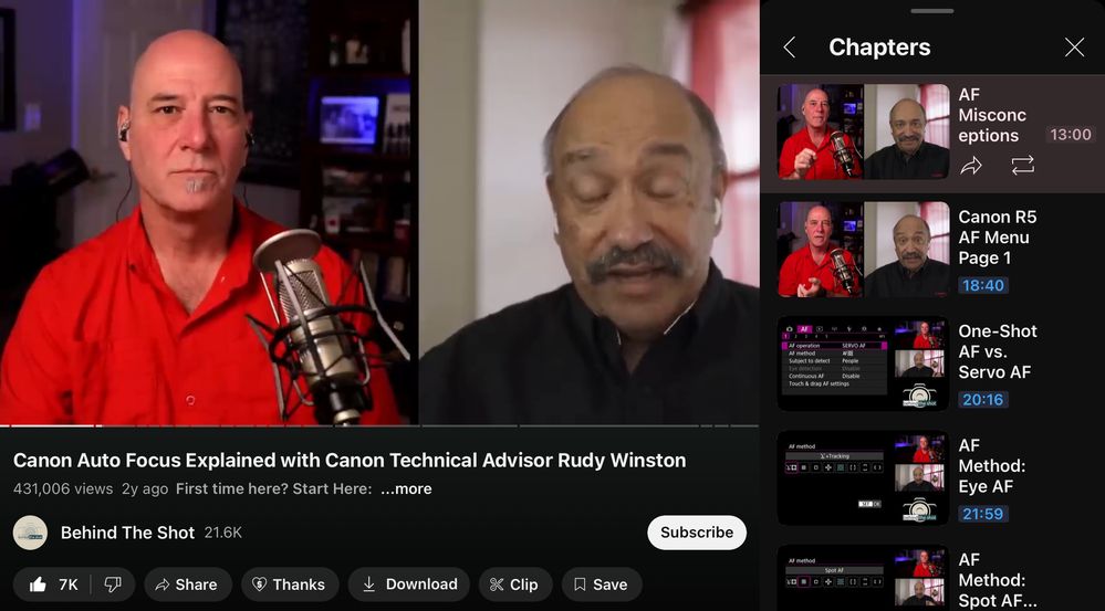

I believe that you need to use one of the Zone AF modes for the advanced subject tracking features to become active.
This is a long video because it takes a deep dive into every aspect of the AF system on R series cameras.  The video also has a chapter feature, which allows you to jump to different topics under discussion.
This is what the chapter display look like.  Note the time index of each chapter is provided.
