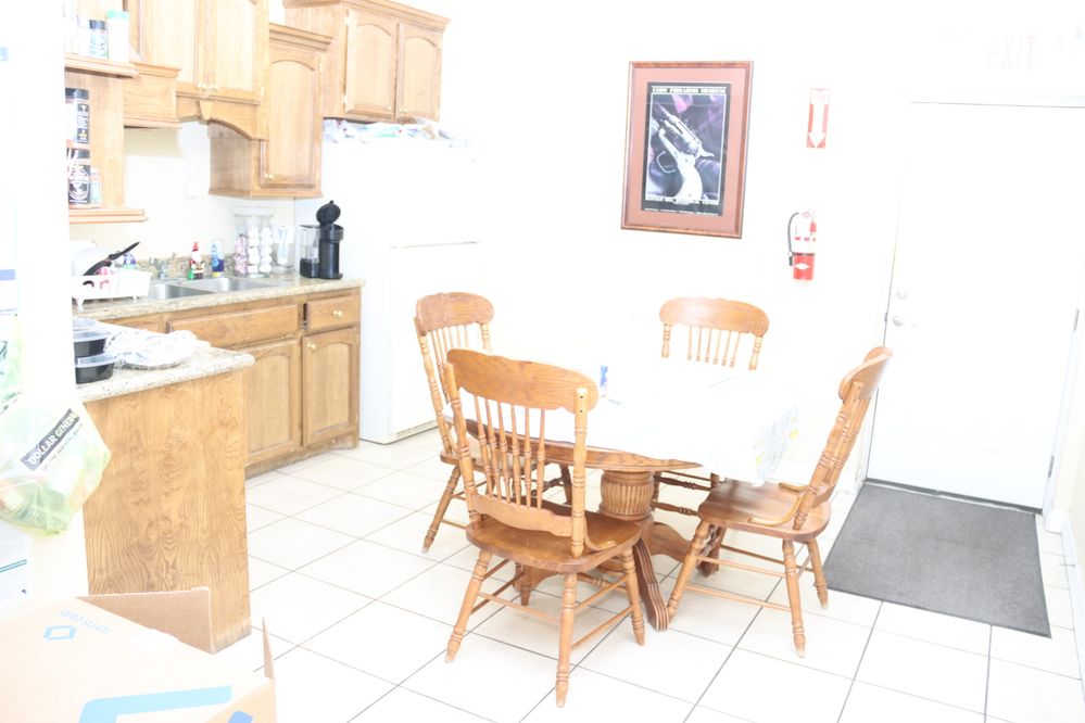

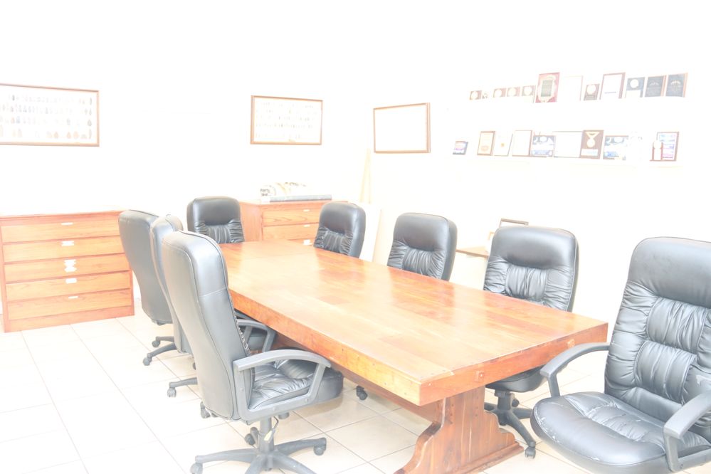

Here's a sample. Again, this was shooting in full auto mode on both the camera and flash. Always worked fine with my older EOS 60D, but, well you see the results here with the 90D.

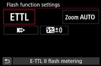

I would check the speedlite’s LCD screen and ensure it says “E-TTL”. If it says “TTL” that means it’s NOT communicating with the camera correctly. Old off the film TTL relied on light reflected off the film. Since a digital cameras don’t have film. The flash will fire at full output only. Later EOS film bodies dropped support for off the film TTL. They act the same way as a digital camera. The flash will fire at full output only and cause overexposed shots. Older speedlites such as the 430EX II supported both E-TTL & TTL. But the flash communicates with the camera and sets the flash to the correct autoexposure mode. Ie EOS 90D would set the flash to E-TTL. But the old EOS 650 (film camera) would set the flash to TTL. There is no user selectable choice to set E-TTL vs TTL. Like higher end flashes like the 600EX II-RT. With the EOS 90D set to P Mode go into the camera menu and look for “Flash Function Settings”. The camera should show you the picture below. If not your flash IS NOT communicating with your camera correctly. If the camera reports an error message that says it cannot communicate with the flash there’s a problem. The camera cannot communicate with the speedlite leading to overexposed pictures. The 430EX II supports controlling it from the camera’s menu screen. If this isn’t possible there’s more going on. Only older speedlites such as the 550EX cannot be controlled this way.
10-23-2025 03:27 PM
Thanks for the hints. I did go to the menu with the camera in P mode just now, and the screen looks just like the illustration in your post. I also snapped a couple photos here in my own office just now, with all the same settings as the overexposed shots from yesterday, and these look fine. Maybe yesterday was just a weird fluke? I did notice on the camera screen yesterday that things looked overexposed when I took them, but I thought the photo-editing software on my computer would be able to adjust them enough to be usable, so didn't worry about it at the time. Sadly, they were too over-exposed for my old Corel PhotoImpact X3 software to correct and make look decent--at least not with my limited proficiency at making adjustments in that software.
