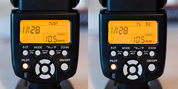

Here is a sample of what S1 and S2 may look like in the flash menu.
