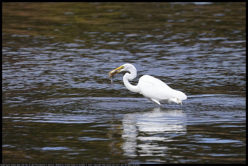

This photo was made from my car window handheld with no beanbag. The bird was moving and one shot out of six seemed good enough to keep to me. For the others, there was some motion blur or the bird moved in a way the camera could not track while focusing or the bird's head was turned. Even if the red box is on the eye, the bird might have moved between the time the position of the red box is saved and the time when the photo is made. The raw file was processed using Canon DPP software.

Great Egret (Ardea alba) with fish at Lake Thunderbird in Norman, Oklahoma, United States on October 16, 2025Great Egret (Ardea alba) with fish at Lake Thunderbird in Norman, Oklahoma, United States on October 16, 2025

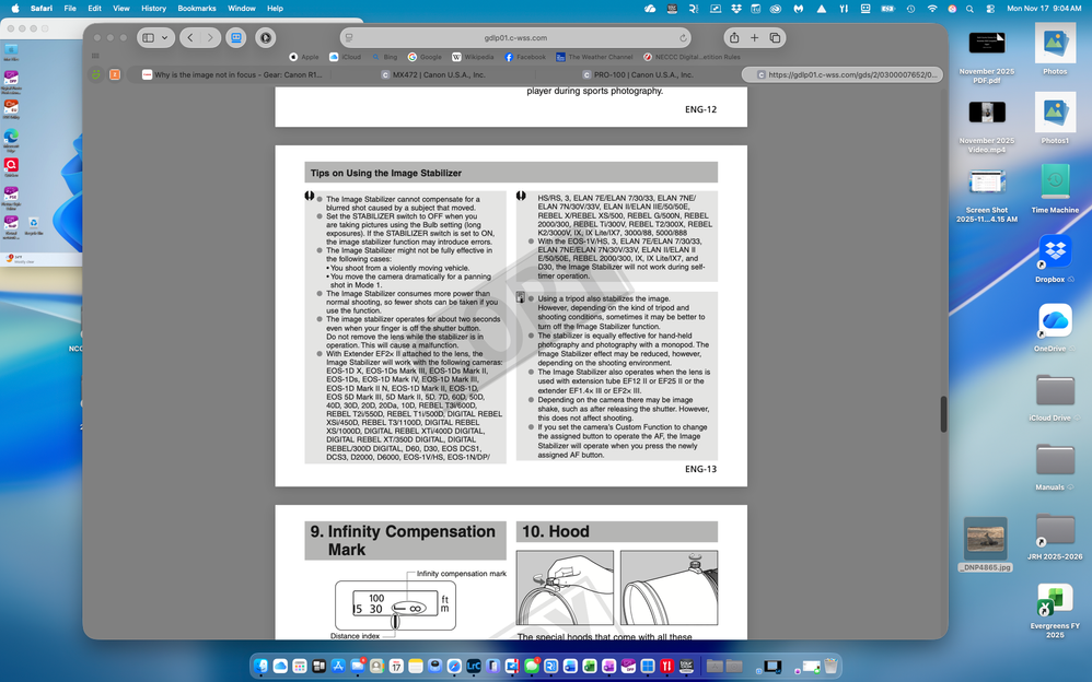

@DhandaNot wrote:
I will try Wildlife photography without eye detection to check and compare.
Here is what Canon states.
