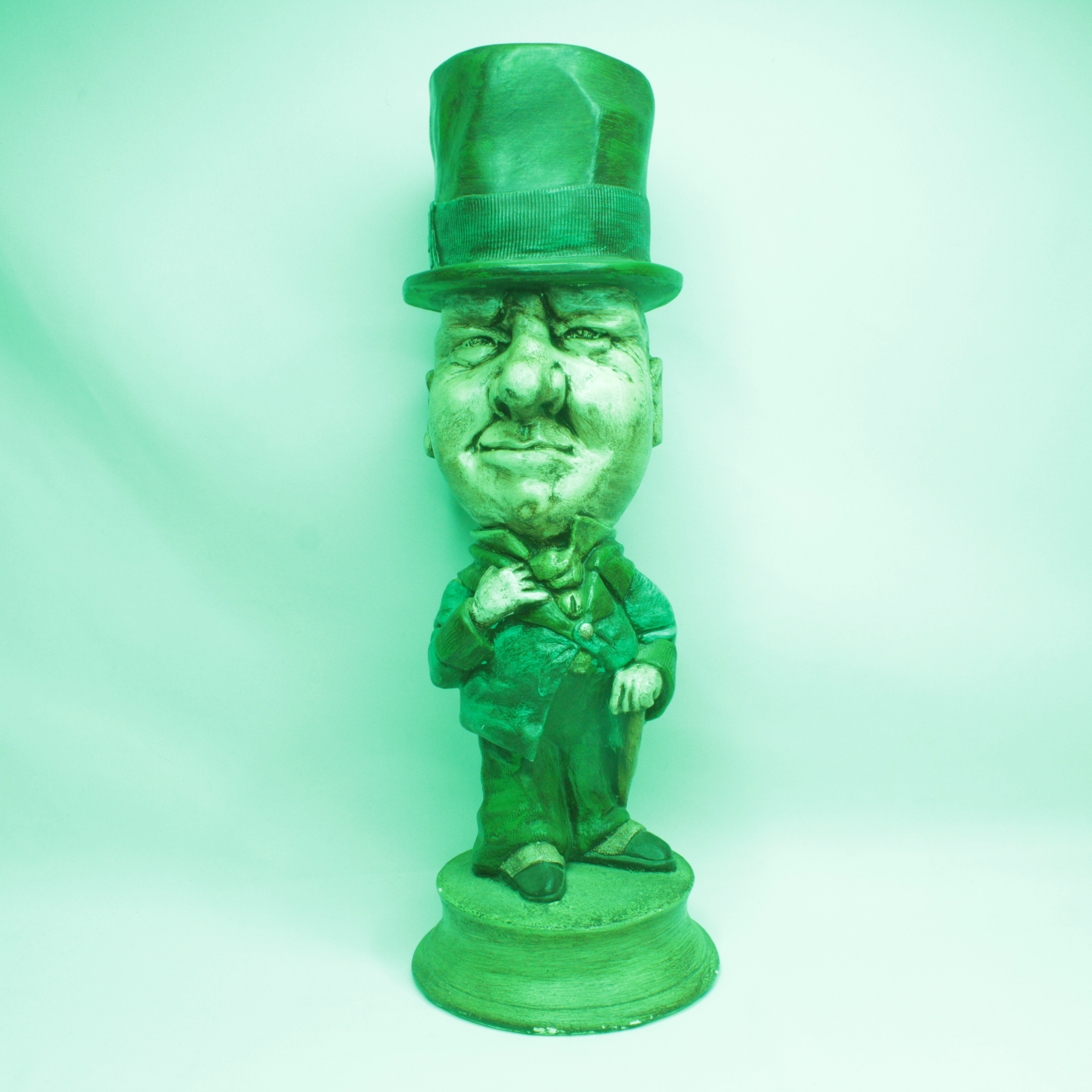

I was following a video tutorial on white balance and was told to keep an eye on my histogram and made sure the bars were close/on the right edge before photographing and setting my white balance photo. Following his directions to the t, but end results are inexplicably green...
I take anywhere between 100-300 product photos a day and was looking to up my photo game. Taking the time to individually edit each photo to knockout the background is NOT an option.
In short:
  • I am using a Canon T3i Rebel.
  • Camera is updated to latest firmware.
  • Adjusting WB SHIFT/BKT has no/very minimal affect on photos.
  • Backdrop is used to set white balance reference, it's as white as paper.
  • 5000k lights used if that matters.
  • Photos look fine if histogram bars have the tiniest bit of separation from edge, but then white backdrop doesn't remain white, remaining off-white and dull looking.
  • Picture below to visually demonstrate what is happening to my photos.

Your photos are green probably because you played around with WB compensation and settings.  Switch the camera to P mode and go into the menus and reset it back to factory defaults.
kvbarkley
Get a grey point reference like a WhiBal.
ebiggs1
Your post and the fact you are using a fairly old Rebel implies, that at one time the photos were good.  Yes, no?
This should tell you, you set something incorrectly or you do have a camera fault.  Do this little test.  Remove any and all attachments to the camera and the lens. Nothing but a bare camera and a bare lens. No battery, no grip, no SD card, no filters nothing .
Charge the battery fully. Install it. Mount the lens and put the switch on AF. Put the camera to "P" mode and reset it to default. Menus, tools, clear all settings and clear all custom settings. Format the SD card. Set WB to average. ISO 200 and use One shot.  Go outside on a nice bright day and take some shots.  Take different subjects. If the pictures look good there is nothing wrong with the camera. And, you did screw up something. If on the other hand they still look off call Canon. 1 (800) 652-2666
