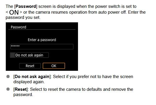

I just got one of my EOS R7 bodies back from Canon Factory Service. When my R7 was returned to me, it had a note stating that the firmware had been updated to Version 1.7.1. This required me to assign a password to the camera at powerup and there was no way to bypass the password assignment requirement. I later discovered that I could direct the camera to not ask me for a password to be entered. Afterwards, I called Canon Level 2 Technical Support and asked the following question: "What if I had the password use left turned on and forgot the password?" I was told that the camera would then have to be sent to Canon Factory Service for repair. The Canon Technician did not know exactly how Canon would reset the camera to allow it to again operate. It's possible that a motherboard replacement could be required. So, I guess you could end up spending a quarter to a third of the cost of the camera to ship it to Canon for repairs it if you forget the password. This is not a very customer-friendly option.

That is a bogus response.
All that would need to be done is reset the camera. You would lose any custom settings; camera would be back to new out-of-the-box condition.
The password is not for theft protection. It is to comply with an EU requirement for protection of wireless passwords.

John, if you had left the password option turned on and then later forgot the password, you would have no access to the menus to perform a reset. Nor could you reinstall a version of firmware. Perhaps Canon has designed a backdoor for their use in such a case, but the Level 2 Tech Support member had no knowledge of it.

03-02-2026 02:30 PM
Don't you see this when asked to enter the password?
No menu needed, just hit "reset"
03-02-2026 02:31 PM
Stephen, does this mean that the setup menu is accessible on the camera without entering the password at powerup? I guess I never tried that, before disabling the password use.
