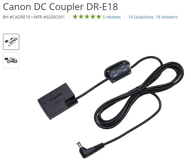

looks like i need one of these, now the only issue is that in order to mount in on my tripod I would have to modify the camera battery door for the cord. Since it connects to a base that won't allow access to the door for the battery.
Thats a problem I can work with though. I just need continuous power.

You do not need to modify the battery door!! There is a little "flap" that folds open to allow the cable to pass through it!
