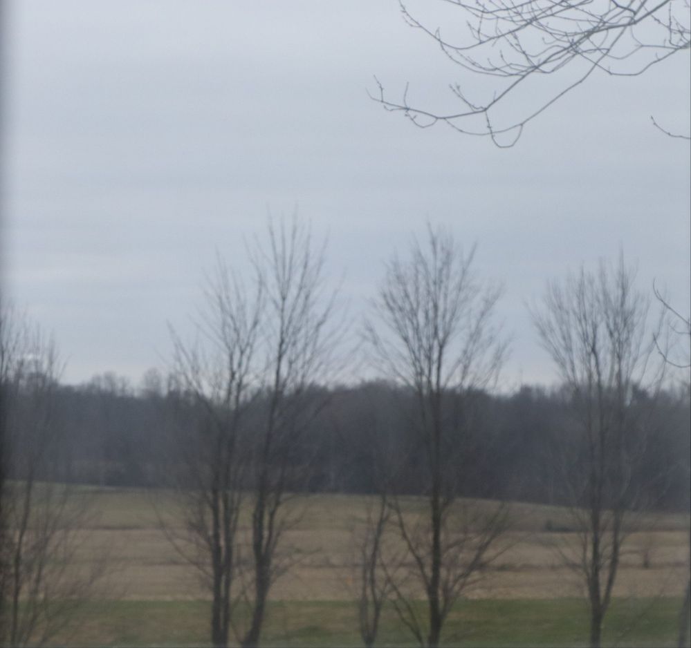

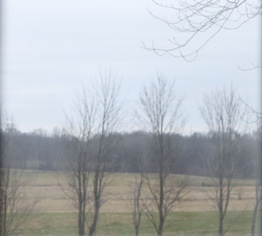

I seem to have developed a problem with my T8i, and I'm not sure what to do about it.
It seems to involve Auto ISO.
When I first turn on my camera and go to take a picture, I half-press the shutter to meter the scene, and set my settings to zero out the exposure. I then fully press the shutter to take the picture. The camera, however, takes a picture that is overexposed.
If I half-press the shutter and take another meter reading a second time with the exact same settings, the camera will take a picture that is more properly exposed.
Here is an example. I used a tripod, so that I didn't inadvertently shift my framing and composition. In both pictures, the settings were 1/500, f/8, ISO 1250.
At this point, I don't know what to except take either two pictures of everything, or stop using Auto ISO. I don't know if I can trust it anymore.
Sometimes that first shot is completely whited out.

If your shots are completely white I'm wondering is the lens aperture always stopping down. What lens are you using when this happens. Is it happening across multiple lenses or just one. What lenses are you using please use full names of the lenses being used. Can you share a file where the picture is completely white. That sound like a classic sign of the aperture blades not stopping down. Could it be the light meter being fooled by the background.
