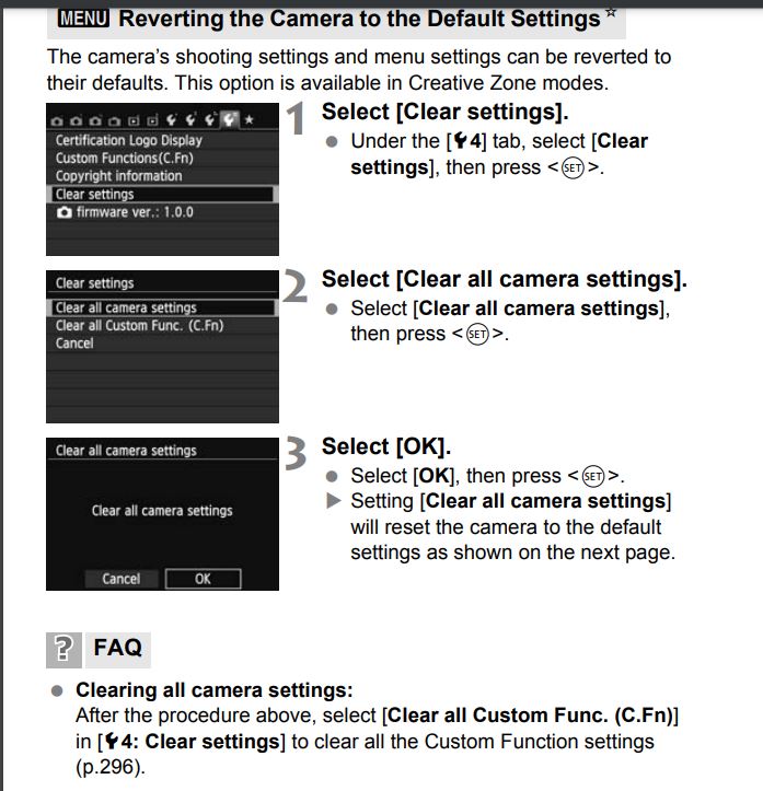

Did you reset your settings to their defaults through your settings menu yet?
Where do you reset to default settings at?
Page 214 of your manual and also reset any custom settings too:
Switch the top dial to P mode so that you can see the full menu system.
