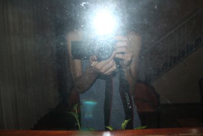

I tried take a picture in a mirror with flash, but the flash dont appear on the image oO. Maybe its out of sync? I dont know what to do.

I can see the flash. Its working, BUT there's no effect in the image like the first image that I posted. I saw the flash but when I see the image its like have no flash at all.
Check out this 2 images. I saw the flash in both, but on the first image theres no effect.
