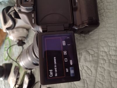

EDIT 2: THIS IS HOW I KNOW THE SCREEN STILL WORKS JUST FINE.... NO CARD, FULL SCREEN.

yes! I did have LENR enabled on my first firmware version, I don't know if when updating the firmware, settings are reverted..
I've also seen this mirror lock thing?
but unfortunately, i can not access any menu's.
I'll try a few days of no battery, I would like to update about the battery, on the 600d inside the battery compartment there is a little open-ish tab, i simply cut the sides with an exacto and plucked that little guy out IMG_20220916_135901661_HDR[1].jpg
I'm going to leave all batteries disconnected again and see what happens.
Will the hdmi cord let me view the menu on the tv?
