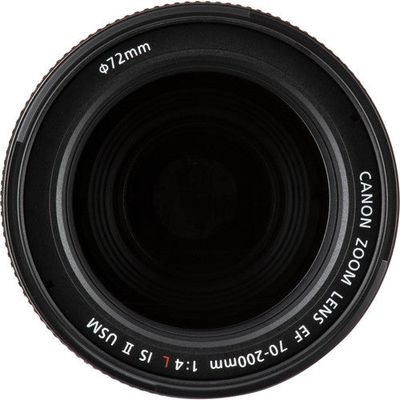

Since your lens has IS then it is NOT the EF 70-200mm F/2.8L USM lens as this lens doesn’t have optical lens IS. The lens IS switch controls both optical lens IS and IBIS. You can’t use each system independently. So you have one of the following lenses below. Please confirm your exact lens model. Having the correct name will greatly help us and prevent confusion. I have an example lens below to help identify your lens’ exact model name. The lens name is visible after removing the lens cap on the outer ring. Have you tried sitting the camera down on a table (or other stable surface) for instance and tried taking a picture with IS off. If you don’t have any access to a tripod. To see if the picture is till blurry.

That is correct Marc. The lens’ IS switch controls both optical lens IS and IBIS. The OP originally indicated that they were using the original non-IS version of the lens. Later in another post they said the lens had an IS switch on it. So the lens they’re using is NOT in fact the EF 70-200mm F/2.8L USM lens. It’s one of the newer stabilized versions. Then they said it’s happening with 2 different Canon 70-200mm lenses. So this is a big confusion now on what’s really happening now. This is what the OP said in the opening post I also purchased another 70 to 200 lens thinking that was the issue and the problem is the same. The blurriness becomes more noticeable the more I zoom in. At around 70mm things are usually fine, but at the longer focal lengths the images become much blurrier. I do not experience this issue at all with my prime lens (35mm).”
