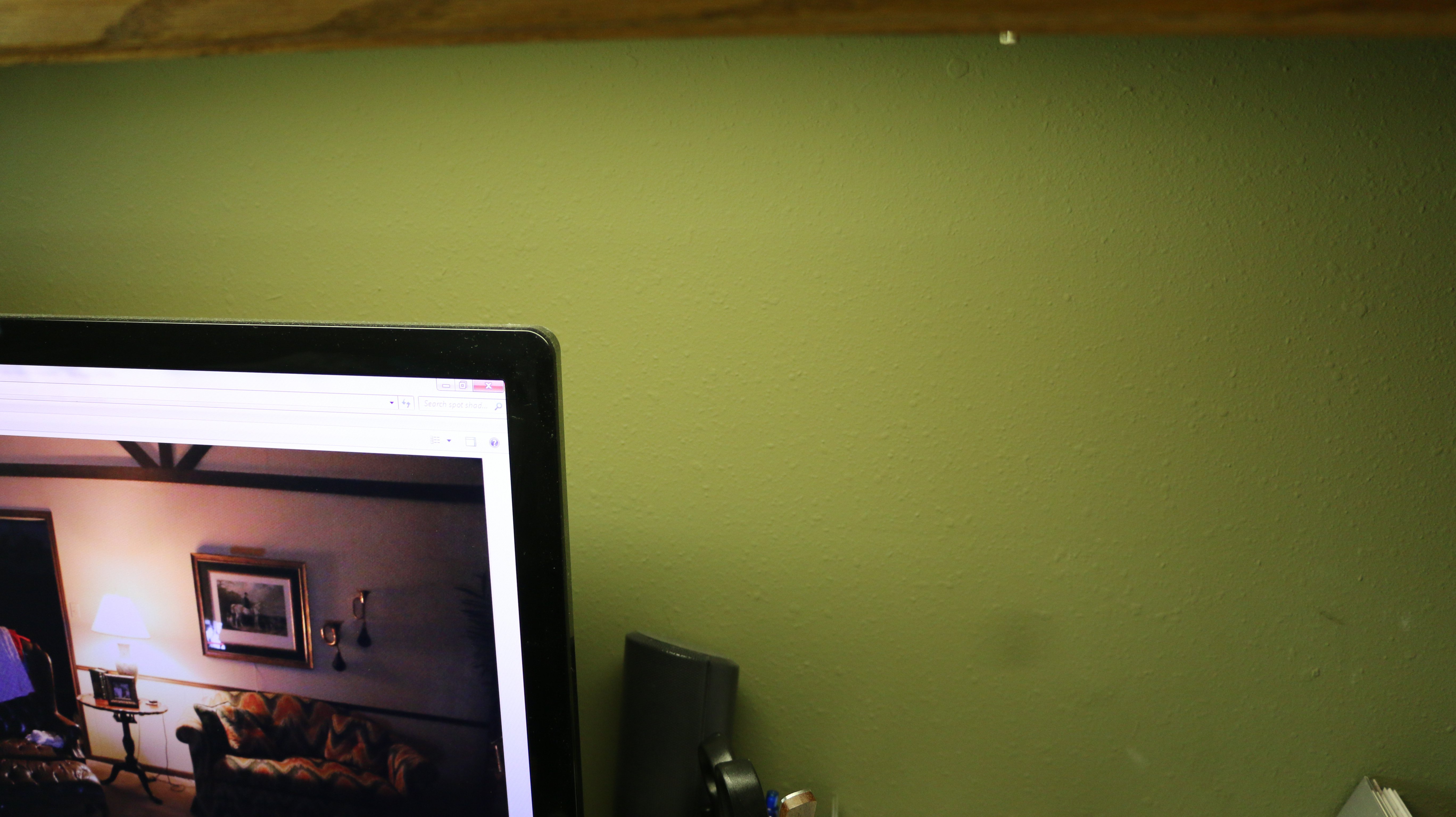

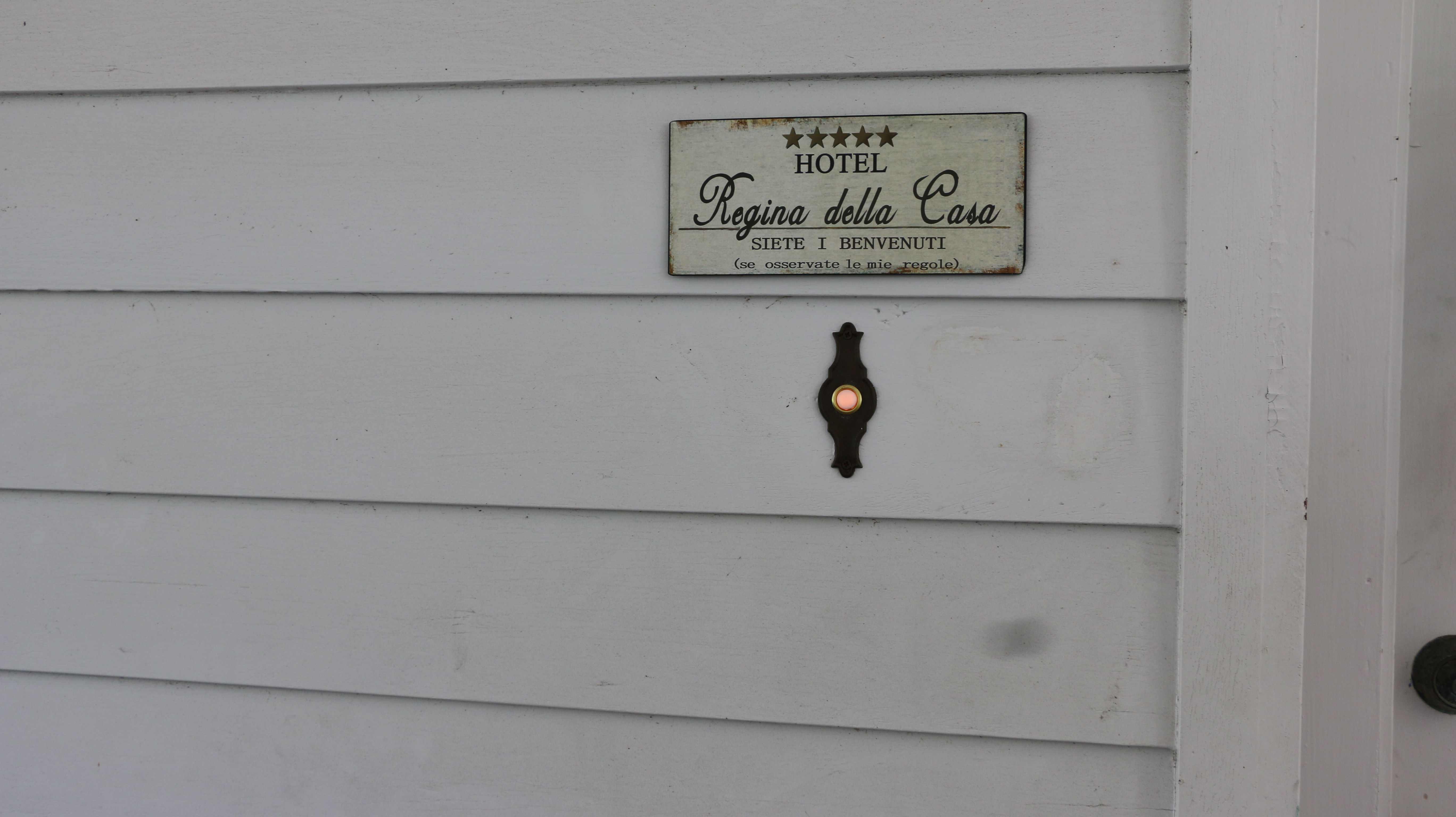

I just posted two photos with spot. They appear in the same place in each shot.

@mchance wrote:I just posted two photos with spot. They appear in the same place in each shot.
That looks like an oil spot on the sensor. Did you buy the camera new or used?
05-04-2015 04:00 PM - edited 05-04-2015 04:10 PM
Bought it new from Best Buy yesterday. The first time I noticed it was in the upper part of the photo and was longer (up and down) It is now where you see it in the two photos I posted
