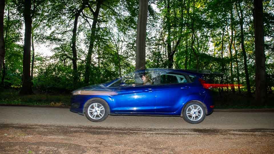

Slow synchro flash combines a pop of flash at either the start of the exposure or at the end and a slow shutter speed. This creates a sharp image of the subject at either the start or end of the exposure and allows blurs to happen in between. Depending on the camera settings and exposure mode, you can have shutter speeds up to 30 seconds and select either 1st curtain (flash fires at the start) or 2nd curtain (flash fires at the end) sync for the flash. If you photograph a car, in low light and use first curtain the resulting image looks like the car is going backwards.
Slow synchro with 2nd curtain sync flashSlow synchro with 2nd curtain sync flashSlow synchro with 1st curtain sync flashSlow synchro with 1st curtain sync flash

When you shoot first curtain, the flash fires at the beginning of the exposure putting the light trails in front of a subject.  When second curtain is used the exposure occurs first, then the flash fires which puts light trails behind your subject.

Taking the car pictures as an example the long exposure no flash result would not show the blue car, only the light trails. So then it’s a case of what you want to show.
