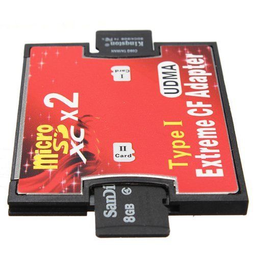

@Waddizzle wrote:
 I never knew that they made micro-SD cards with CF adapters.  The two technologies are so very different that I would not think that they would cross-compatible with one another.
Holy crap! They actually do make such a thing! And it doesn't hold just one Micro SD card, but two! Robot tongue I think I'd rather just stick my car keys in there and wiggle them around and get it over with.
