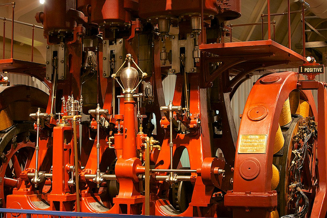

Here are some sample images to help you get the idea. These four images are all really just the same single digital image... but processed digitally using the "color" filters.
First, the color image (so you know what we're dealing with). This is an old electrical generator.
Notice that most of the generator is painted "red".

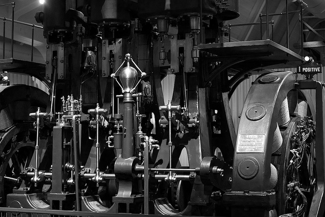

First, I'll show you a straight black & white conversion (no filters are used)

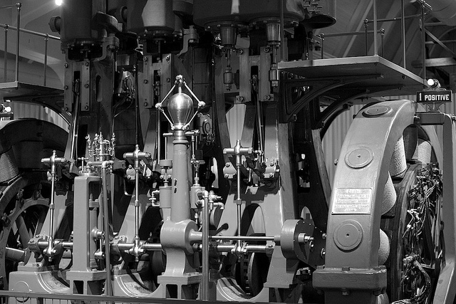

But now look at what happens if I use a "Red" filter (and from the original color image, you know that most of the painted surfaces are "red"... this means they wont be blocked but non-red things will be somewhat blocked.)
You can certainly see how the "red" filter made all the "red" painted parts of the machine appear "white" (because a red filter lets the red light through but blocks non-red light.)
