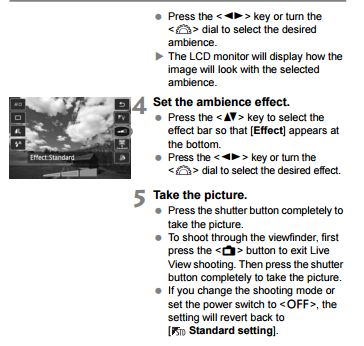

I've had my T5i since September 2015 and I would like to know how do I shoot in grayscale/black & white straight from the camera insteaad of later going into Photoshop to change from color to grayscale/black & white.

The EOS Rebel T5i is able to shoot in monochrome. You can do so by following these directions:
We hope this helps you out!
