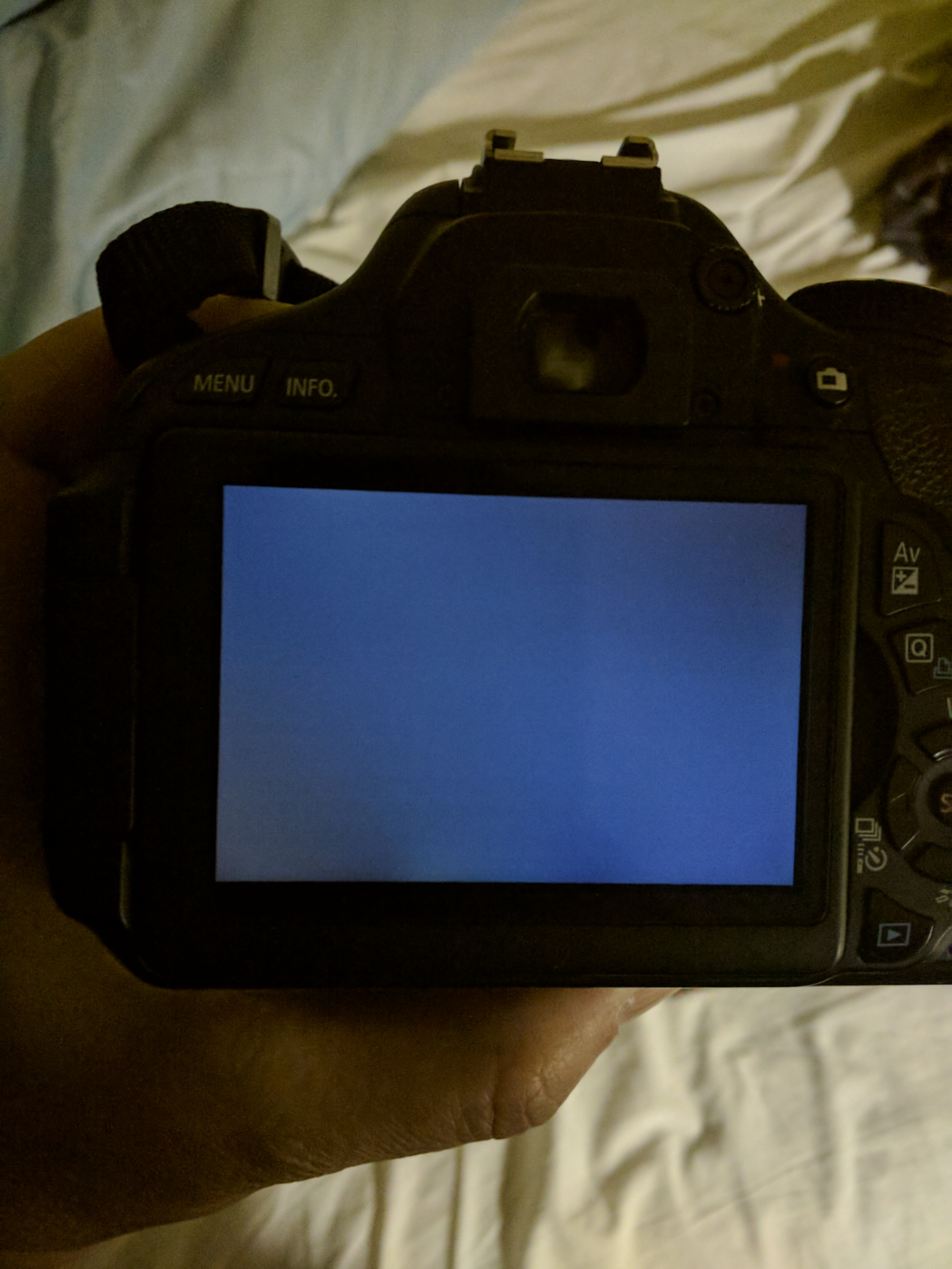

Rebel T3i sustained drop damage. Still takes pictures as expected with no surprises. Plastic is deformed to the right of the HMDI port.
LCD is NOT cracked BUT there's no image, only backlight.
I've reseated both cables going to the LCD screen board. There's no change in behavior. I can replace the LCD and I want to be sure that's the root cause. Previous owner believed repair would cost "$200+" but didn't go into repair detail. The plus part worries me. Will take apart body next and reseat one more cable and was hoping more people can offer input on possible root cause.
I'm wondering whether to replace the LCD alone, the LCD screen board alone, both the LCD and its associated screen board, or worse, something else.

Not sure if Canon is still servicing this model. It seems not a bad idea to check if the wire connection is loose. It is a simple fix if so.
If LCD display is broken, you may consider to replacing the LCD screen + backlight. (It costs US$12 with free shipping) However, It may takes some weeks to arrive in the USA.
There is a tutorial online. (How to Repair Your Broken Canon EOS LCD Screen - Rebel T3i / 600d)
Good luck.

Since the camera has been droped, you should probably worry more about the damage you don't see. That's what the "plus part" is.
Was the lens dropped too? Have you taken test pictures to check out the image quality, autofocus, etc.?
