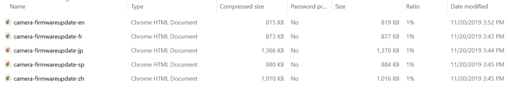

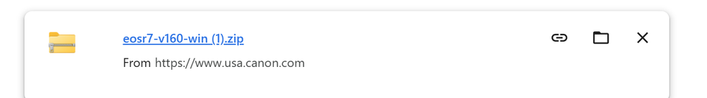

Hi I need help with the firmware update for the R7 ... so confused.
I clicked on the link and got manuals in several different languages ... so where is the firmware, please?
How do I get it on my computer and then to the memory card? Where is this extraction I should have? The directions on the Canon website are useless ... I would appreciate step-by-step ..
Something is on my desktop, but what comes next? I have an empty card inserted into the slot. Where is the update to put on the card? I presume the card gets inserted back into the camera. What do I do? How do I get it on the camera? Does it do it automatically once the firmware is on the card and in the camera ... I thought I clicked on the right download. Thanks in advance
