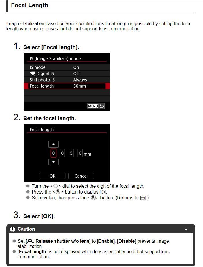

I have found a bug in the R7 firmware v1.2.0 through 1.6.0
With manual lenses that have no communication, the IBIS Image Stabilization is not working as expected. It is not using the correct "Focal Length" value that is inputed. IBIS is enabled, but it is ignoring the value that is set when turning the camera on. You can temporally fix this turning IS OFF, and then focusing with half press, then turning IS back ON. The R7 IBIS then behaves normally with the correct "Focal Length" value. When the camera is turned off, or goes to sleep it breaks again. This behaviour is best witnessed by using the 10x zoom through the viewfinder. You will see the effect of IBIS with IS ON as-is with incorrect value interpreted (Slight shake correction), with IS OFF (No shake correction), and finally with IS ON with correct value interpreted(Fantastic shake correction).

Wow, I just joined these forums and I am amazed at the sloppy responses, some incorrect and some just arrogant. The brand of the lens is irrelevant. The camera provides image stabilisation for any lens based on its focal length, regardless of brand. The OP clearly stated what the manual says and it cannot be any clearer!
"Image stabilization based on your specified lens focal length is possible by setting the focal length when using lenses that do not support lens communication."
What part of that statement suggests brand has anything to do with the question being asked? The lens does not have to support communication and it states that.
