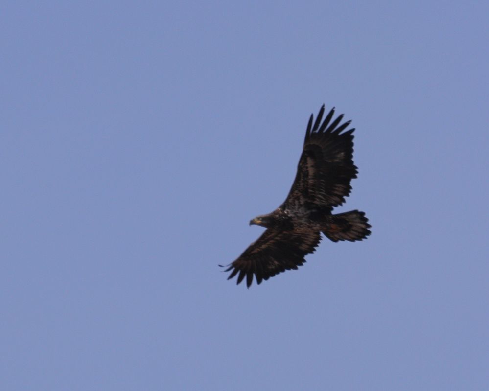

Bald Eagle, Jan. 17, 2023, far away and cropped smallBald Eagle, Jan. 17, 2023, far away and cropped small

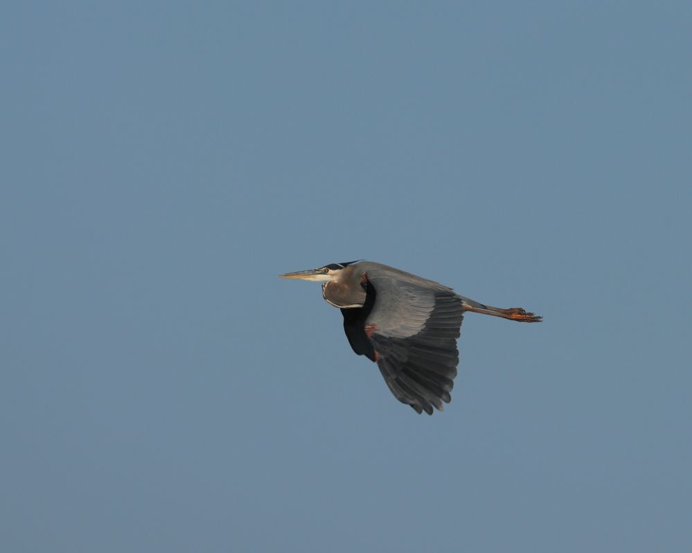

Great Blue Heron, Nov. 16, 2022, far way, cropped smallGreat Blue Heron, Nov. 16, 2022, far way, cropped small

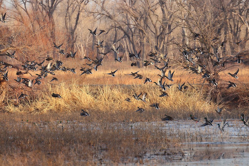

size reduced to permit upload, Mallards Jan. 17, 2023, far away but I still startled themsize reduced to permit upload, Mallards Jan. 17, 2023, far away but I still startled them
