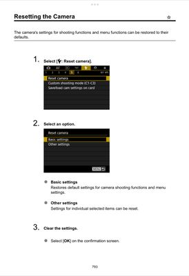

I suggest resetting the camera as a last resort. Before you do that, have you tried switching the Shooting Mode Dial to Auto, to see if it works? Pressing INFO while looking through the EVF?
If you perform a reset m, don’t immediately begin changing settings. Switch the shooting mode to P and test it.  

It's not wise to upgrade firmware when as camera is malfunctioning or exhibiting unexpected behavior.  Start with a factory reset.
Pressing the info button repeatedly should toggle through the available displays.  What displays is determined by the check marks you select.
Start with a reset and re-verify the behavior.

If you are sure that you have all of the boxes checked and SET, then the only option I can recommend is to reset the camera to factory. Sounds drastic, but if that sounds too painful, then it may be the problem to begin with in that sometimes in our wish to bend the camera to our will, we go a bit to far and settings conflict 🙂

Update: I checked all the boxes in the Shooting> Tab 9, but there was no change.  Then I hit Reset.  The problem is still there, but the information is properly displayed in the back screen.  I will hit Reset again and toggle (one by one) all of the settings that I previously used to see if something triggered the issue.  If there is no change, I'll call Canon directly.  This is a fantastic camera and I urge all of the users to record their settings.  Wish me luck!
