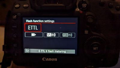

@LeeP the AD-E1 hot shoe adapter is for use with weather sealed flashes on R series cameras with a digital hot shoe. The weather sealing gasket prevents it from mounting correctly. The EOS R8 would be one of those cameras. Older EX series speedlites DO NOT require this as they don’t have a weather sealing gasket. The EOS R50 requires it for older style flash units. Other cameras with the digital hot shoe still contain the legacy pins or older style flash units to work. Now the flash that came with the EOS Elan IIE was the 380EX. It will work on modern cameras with full functionality. Though the in camera flash menu will NOT be completely functional. The camera retains the ability to set 2nd curtain Sync and Flash Exposure Compensation (FEC). Note the HSS switch on the flash overrides the camera’s ability to set 1st or 2nd curtain sync. The Flash Functions Menu is still available to show current Flash settings.
