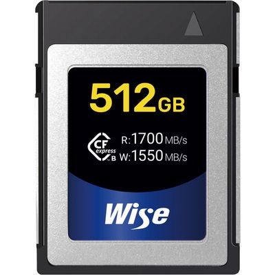

Which memory card is being used to save your video?
08-14-2020 01:06 PM
I'm using this one:
08-14-2020 01:50 PM

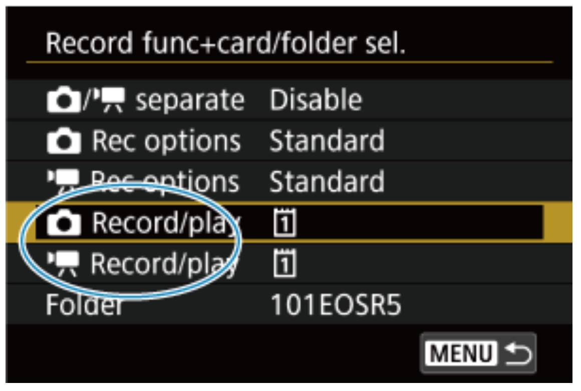

Have youtried changing the Recording/Playback card selections? i.e.: "Standard" , "Auto Switch" or "Card-1" only?
08-14-2020 02:08 PM
One other thought: Setup Menu-1: You might try try switching "Still/Video Seperate" (Enabled/Disabled). The R5 has many buried menu functions that if enabled can disable or limit other functions which are not mentioned in the manual.
