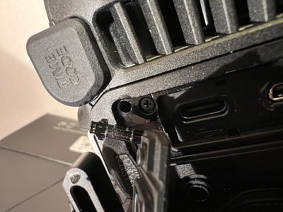

11-26-2022 02:36 AM - edited 11-26-2022 02:37 AM
a little lubricant and a quite hard wiggle with a pair of narrow pliers.

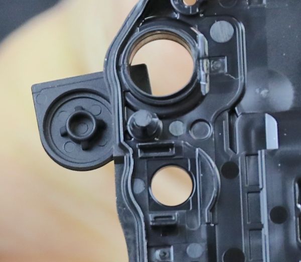

However...I did come across one teardown of an R5, one which actually gives a great shot of the back side of that panel and what is on the inside of those port covers. its on this post here:
https://www.lensrentals.com/blog/2020/09/taking-apart-the-canon-r5-mirrorless-camera/
5T5A0019sml
You can see here that inside the camera that rubber tether just flares outwards to keep it in place. During assembly it must have just been pushed through that hole (I understand from docs from other cameras that a small tool like a toothpick can be helpful in pushing that wider part through) I don't see any reason why they couldn't be removed and reinstalled even if it was never designed with that intent in mind.
the question is if it was not designed for that feature, would the tether break before the wider part of the tether pulls through the hole.

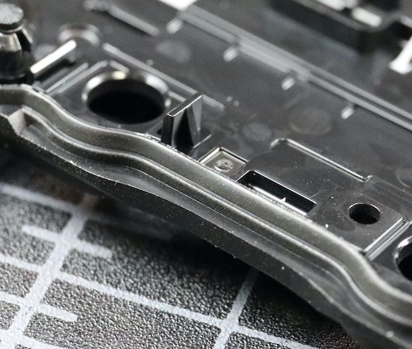

09-02-2022 06:08 PM
Some other close ups
5T5A0021sml
gasket-sml
It looks however that the tether might have been designed to be insert-only, there's a bevel on the part that pushes through first, the other side of it may be just flat. I can't really tell but it almost looks like there must be a plastic retainer or something on them also, if that's the case it may well be impossible to remove them without breaking them. if that's the case that's terribly disappointing.
