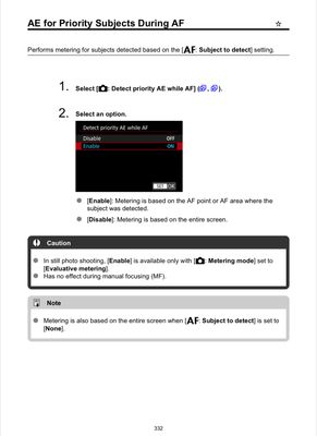

If we all agree that Evaluative Metering is biased on point in focus , then what is "Detect priority AE while AF" for? This is a new option introduced with R5Mk2 and works only under two concurrent conditions: Evaluative Metering + a SUBJECT is in focus, where subject is a person, an animal or a vehicle. SUBJECT is key here, because for "Detect priority AE while AF" a chair in focus or a house in focus or a tree in focus is not a SUBJECT.

When "Detect priority AE while AF" is on and a subject is detected and in focus, is the metering taken only on the subject, without considering the whole scene?

Yes this I understand and I agree, but then what's the purpose of "Detect priority AE while AF"?
This seems redundant if Evaluative already has a bias on the focus AF.
