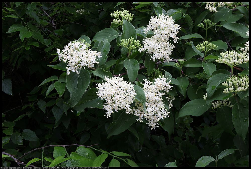

For the image below, I used F/8, the camera made 11 shots and I did not use all of them, the focus distance reported by the camera in metadata ranged from 0.62 meters to 1.33 meters. I used Canon DPP software to stack the raw images.

Roughleaf Dogwood (Cornus drummondii) blooming in Norman, Oklahoma, May 17, 2021, EF-S 18-135mm f/3.5-5.6 IS USM , camera made 10 images but I did not use all
