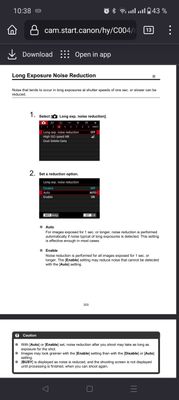

As already written, use a dark frame. For example Long Exposure Noise Reduction. This feature takes a second frame and removes hot pixels and amp glow.
Use the sensor cleaning method if you have hot pixels also at short shutter speeds.

I know how to remove them using software tools or just by enabling Long Exposure Noise Reduction in camera.
My main question is - does the amount of seen broken pixels in my photos are ''Normal' or are there too much of them so I need to service my camera. Sensor cleaning feature does nothing to minimize those broken pixels for me.
