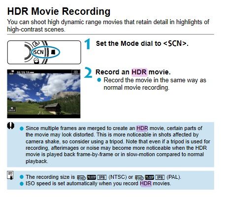

You can try Movie HDR:
But of course the traditional way is to put neutral density gels over the windows.
thank you for the advise, I'll give it a try

Thanks for the advise. I tried the first suggestion by setting the camera mode to "SCN" but it didn't work as I hoped. From what I'm hearing, my most practical solution is to make the interior brighter to match the light that is coming through the window.

What? There's HDR for video now? Geez . . . I guess I need to start reading my newsletters again.
